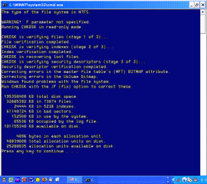

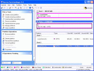

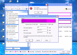

RESULTS OF CHKDSK
I am going to include 3 gifs with this post.
First is screenshot of chkdsk
Second is Norton Partition Magic summary screen
Third is error message given when trying to resize using Norton Partition Magic.

Posted by: jaclaz Nov 21 2006, 02:03 PM
I have not much ideas left:
1) Chkdsk sees the partiiton allright ÷190Gb
2) Windows Explorer ALSO sees it allright ÷190GB
3) Norton Partition Magic ALSO sees it allright ÷190GB
4) The error comes when you try to resize it
That MUST be because somehow the disk (not the partition) is seen as having 16709 Cylinders, i.e. 132 Gb, and this happens with:
a ) MBRFIX
b ) TESTDISK
c ) BEEBLEBROX
d ) NORTON PARTITION MAGIC
Results 1) to 3) are normal as to read information on the partition the MBR is read, which as said, is correct.
Results 4) and a ) to d ) are also all coherent as to read information on the drive geometry the disk driver is interrogated, which actually interrogates the hard disk.
