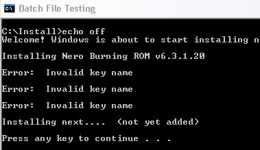

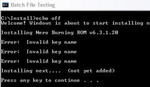

Thank you for that post. I still get "invalid key name" when testing the batch file. Also I am not sure how to change the SFX script in Winrar. What I did manage to change it seems, is simply the comment about it. Please advise ??
REG ADD %KEY%\1055 /V 1 /D "%systemdrive%\Install\Nero\nero63120.exe /silent /noreboot /no_ui /sn=xxxx-xxxx-xxxx-xxxx-xxxx-xxxx /write_sn" /f
You need to edit the line and put your own key in
I have put my own serial number in for Nero. I think the error is regarding the "registry" key. I must be missing something. Can you advise further?
