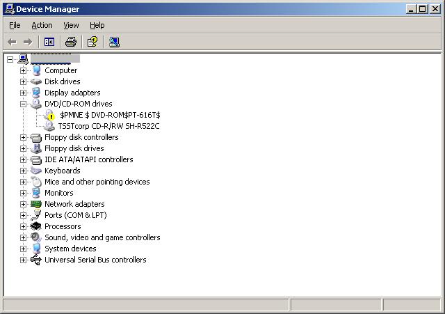

Recently, i upgraded my SDRAM from 256MB(128*2) to 1GB (512*2), and after few days changed by Motherboard battery. Now i am facing these problem:
1. Occasionally, windows xp restarts in middle withought giving any warning. For past 2/3 days it has stop doing so. I didnt know why was it happening, using crash-dump analysis, i found some sys files crashing. (But found no apparent reason).
Now the major problem which occured:
2. My DVD drive name changes (gibberish or bad characters with $ character) on every boot in BIOS and thus i cannot use this drive in windows xp. (Since windows xp dont recognise this drive).
In BIOS, i tried using auto-detect several times, but found no solution.
Windows xp worked perfectly correct for 2/3 days after i changed battery.
I am confused.
What could be the problem? has someone faced such thing?
Please help me find the solution or guide me in correct direction.
p.s. attached is the image of Device-Manager

really bad luck of mine, i re-opened my cpu box, re-connected data cable of DVD-Drive to motherboard, and then started my windows, now the Drive is not even showing in Windows Hardware.
I am worrying, what could be the problem. All this is happening when i installed 1gb ram from 256MB. I dont know wther my motherborad(i845) is getting appropriate voltage to handle 1gb ram? and worrying whether in future my cd-write wont get damage by all these.

No, changed with a new PATA cable (with CS jumper set), still the problem remains.
My DVD is on Secondary-MASTER (with CS selected) and CD-Writer on Secondary-SLAVE.
Now, what i did was, i disconnected my CD-Writable power cable, and then It was all fine and the problem solved. That means with 1Gb of RAM i can connect only 1 optical drive at a time.
Otherwise the problem remains, and what i also noted is the DVD-Drive changes from:
PINE DVD-ROM PT-616T
to
PINE $ DVD-ROM PT-616T$
and then again to
i.e., $ keeps on adding to correct device (DVD-Drive) identifier.
Now, what i m thinking is whether my system can afford that much power(Voltage) (my motherborad is i845)?
Since disconnecting RAM is very difficult in the box, i will try removing or changing SDRAM (downgrading to 512mb) next time and tell u the result.
