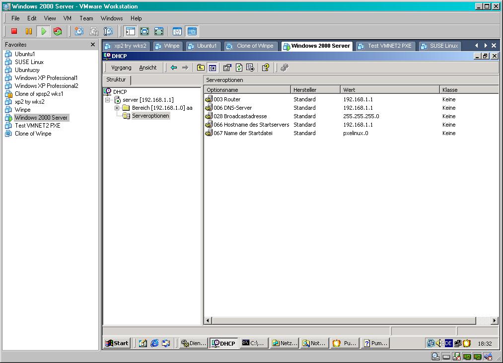

geemail.email
Kyor,
I have been using the 3Com boot services and I have bene able to successfully boot to my custom WinPE image. However, I would also like to add the WinPE image to a menu and add the choice to the meny to boot from hard disk. Since the 3Com services don't support boot WinPE from a menu, I found this thread which sounded like a solution to my issue.
I have followed your step by step guide for PXE boot with pxelinux but without much luck. First, I want to make sure, I can use a windows workstation as my TFTPD server?
Also, if I follow your step by step, what is acting as the PXE server? With 3Com, I have to start both the PXE server and TFTP server, but with your instructions, I would only be running TFTPD32. I am running DHCP on another server so I can't run the DHCP server from TFTPD32 and hence, I am not configuring TFTPD32 as a DHCP server. Do I need to somehow add the "pxelinux.0" boot file to my DHCP server?
Thank you in advance for any additional guidance you can provide
Geemail
kyor
Yes thats right. You have to configure dhcp options. If you use Windows Server add optition 66 and 67.
See my example.
