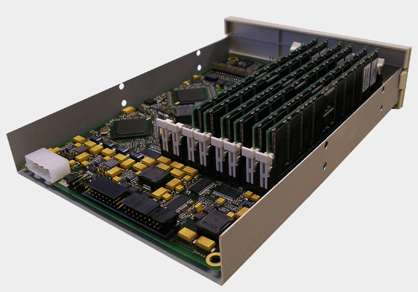

http://www.hyperossystems.co.uk/
http://www.hyperossystems.co.uk/07042003/HD3techspec.htm
http://www.hyperossystems.co.uk/07042003/img/HD3zoom.gif
^good picture here
The HyperDrive III is quite simply a Hard Disk made out of DRAM. It therefore connects and performs like an impossibly fast Hard Disk. Here are the technical specs:
CDROM drive form factor. Fits into a standard 5.25" CD bay.
Connects just like a Hard Disk or a CDROM.
PATA(IDE) or SATA
Unlike the HyperDrive II which only took on board RAM. The HyperDirve III provides 8 DIMM slots, each of which can take DIMMs up to 2GB in capacity (no on board RAM). So max capacity is now 16GB.
Retains data when the PC is restarted or shutdown by having an independent power supply connected to the main PC power lead through a PCI slot blanking plate.
Integral 160 minute 7.2v battery back up to cover electricity board power outages (1250 milliamp hours - on board trickle charge unit takes 48 hours to fully charge).
thinking about getting one..
you've gotta buy the ram seperate i think..
would be perfect for nlited xp, on 2gb of ram.. -can ghost back to it in no time if you did lose power and lose the o/s
