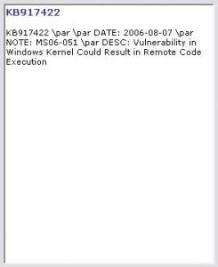

I'm having the same problem with RTF encoding as well. I'm using version 2.2.0.0 with this line:
HELPTEXT.0.64=KB917422 \par \par DATE: 2006-08-07 \par NOTE: MS06-051 \par DESC: Vulnerability in Windows Kernel Could Result in Remote Code Execution
The text renders, but so does the \par tags. They are supposed to put CR-LFs into the displayed text, but it's not happening. This *DID* work on older versions though. I also don't remember the blue title in the help pane when you click on a item in previous versions.
Click to view attachment
Camarade_Tux
As a workaround, I think you can try using \n to start a new line.
Maelstorm
I'll try your suggestion and post the results here.
[EDIT]
I tried it, and it didn't work. The \n tags were displayed right along with the text.
