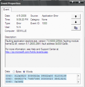

MillenX
Apr 5 2008, 07:25 AM
DigeratiPrime, sorry for coming back late...
Anyway, I have the problem again... And this time I have
one website that causes the
error. I will provide more in the next coming.
http://www.encyclopedia.com/doc/1E1-ammonnit.htmlhttp://www.wincert.nethttp://lifehacker.com/software/how-to/save...ings-258411.phphttp://lifehacker.com/software/how-to/save...ings-258411.phphttp://www.naymz.com/search/yuka/yamamoto/1306887And I got a text file which includes the error information. The text file named
101_appcompat.txt, produced in the %temp% folder when the error occurs. I think it may help you to analyse.
Click to view attachmentClick to view attachmentDescription:Faulting application iexplore.exe, version
7.0.6000.20544, faulting module kernel32.dll, version 5.1.2600.2991, fault address
0x00012a5b.
Bytes:0000: 41 70 70 6c 69 63 61 74 Applicat
0008: 69 6f 6e 20 46 61 69 6c ion Fail
0010: 75 72 65 20 20 69 65 78 ure iex
0018: 70 6c 6f 72 65 2e 65 78 plore.ex
0020: 65 20 37 2e 30 2e 36 30 e 7.0.60
0028: 30 30 2e 32 30 35 34 34 00.20544
0030: 20 69 6e 20 6b 65 72 6e in kern
0038: 65 6c 33 32 2e 64 6c 6c el32.dll
0040: 20 35 2e 31 2e 32 36 30 5.1.260
0048: 30 2e 32 39 39 31 20 61 0.2991 a
0050: 74 20 6f 66 66 73 65 74 t offset
0058: 20 30 30 30 31 32 61 35 00012a5
0060: 62 0d 0a b.. Words:0000: 6c707041 74616369 206e6f69 6c696146
0010: 20657275 78656920 726f6c70 78652e65
0020: 2e372065 30362e30 322e3030 34343530
0030: 206e6920 6e72656b 32336c65 6c6c642e
0040: 312e3520 3036322e 39322e30 61203139
0050: 666f2074 74657366 30303020 35613231
0060: 0a0d62Thank you
DigeratiPrime!
cluberti
Apr 28 2008, 08:16 AM
Seriously, an error in IE hitting kernel32 could be ANYTHING. Get a
memory dump from Internet Explorer crashing, so we can stop speculating

MillenX
Oct 3 2008, 08:55 AM
As I have told, I met the same problem of IE crash and today I have found out that it was the Flash Player. Though it was not te main cause but many got affected. I thought it was the problem of IE itself so I rolled back to IE 6. Could not take the hook off the problem, but at least I was revealed to the real cause. The old IE 6 displayed an error with the flash.ocx file, which is the Adobe Flash Player. So, the solution is, go to give your IE an update of the flash player. I got and install the currently latest version which is a Release Candidate, version 10.0 something and it finally rectifies the problem. And I have got IE 8 beta 2 now. Thanks to everyone!
DigeratiPrime
Oct 4 2008, 01:33 PM
We would have known immediately if it was a problem with a plugin if using the '-extoff' cvar allowed the websites to load.
Also with a memory dump we would have seen in the stack trace a failure in the ocx module.
But kudos for the information and for figuring it out!
