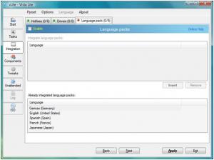

I've tried, but unable to remove...the languages stays on "already integrated language packs", and it's grayed...can't remove them...is there any way, with vlite or waik?
I can't remove either. And if you remove the language pack folders that you don't want, an error occurs during the installation mad.gif
I am facing the same problem.
Click to view attachment
