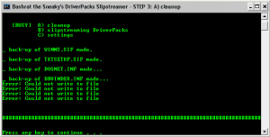

Hey Siginet, I keep on getting this error, even after using a source that isn't "n-lited". What I'm I doing wrong? here is my settings.ini, just in case.
CODE
[InputOutput]
XPSource=K:\XPHR
XPDestination=H:\LOOT\OUTP
[Exclusions]
WIN9XUPG=Y
LANG=Y
[Extra Files]
ExtraPack=N
ExtraPackDest=
ExtraRoot=N
ExtraRootDest=G:\BACKUP_D\PowerPack_Files\PowPack CD Files Pro
[Custom Options]
Tri-Pack=Y
PackNameOn=N
PackName=XMPC
[Unattended]
Unattend=X
Winnt.sif=K:\XPHR
$OEM$=
[DriverPacks]
DriverPack=P
DPSource=H:\LOOT\UWXPCD_ROOT
[WinXPVersion]
XPVersion=H
[WinXPEdition]
XPEdition=R
[Win2k3Version]
2k3Version=
Siginet
That seems to be a driverpack issue. Try to use the driverpacks without powerpacker and see if you get the same problem. If you do try to remove any read only attribs from your i386 directory then try again. Powerpacker should be removing the read only attribs though.

hbinded
It works now, perfectly, althought the copy process is a lil bit slow. Maybe it's my on PC's side. Otherwise, it works OK. Nice work!
