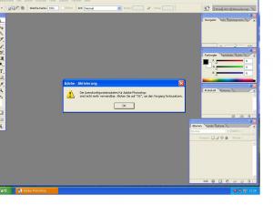

willybald
Sorry for my bad english im from Germany
Product licens File not workClick to view attachment
atomicrabbit
QUOTE (willybald @ Jun 27 2006, 04:30 AM) *
Seems as though your screenshot is referring to Photoshop. This topic is about Adobe ACROBAT Pro.
