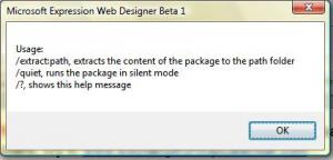

Just as the topic states.. I have yet to find a MS tool that assists me with a silent install of Expression Web. Does any one know how?
neo
Use /? switch to get advace installtion option.
Click to view attachment
Triel
TY very much.
There must be a difference from Beta 1 and the release since I do not have the options you have.
