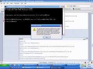

Well I got the 117.7mb file(currently downloading from your link to see if there is any difference... It won't work out the way I want, the installation starts but then suddenly ends(see screenshot) and this happens for both the english(117mb) administrative file and the danish MUI(25mb) version...I'm 100% sure that I've got the danish version because everything in my office is in danish(using english winXP though(free thru my university) that's why the error is in english) -

Hi there! This is my first try with unattended windows and slipstreaming updates into xp/office I followed the guide at unattended.msfn.org buyt can't slipstream the SP3 into my PRO11.msi I've tried both the english SP3(117mb) and the MUI(25mb for danish) first i tried with the normal SP3 files but found out that I needed the administrative version(with seems pretty hard to find on microsofts homepage) - finally I found a guide somewhere on the internet(cant remember the link - got it on my laptop so I can post it tomorrow) with a link for the english administrative version(or so it says) and a link for the MUI's, I followed the guide but just got a message telling me that the file is not the right one or something like it(both for the english MAINSP3.msp and for the MUIxxx.msp) when i try to slipstream it into PRO11.msi(unpacked with setup.exe /a) Can anyone help me out on this one, how do I slipstream SP3 into office 2003(danish) and do I need the danish MUI first? So far i tried the msiexec /p method without any luck thanks!
