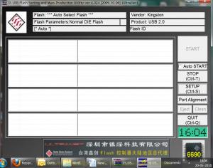

After the third reboot after having deleted dummy.sys and the corresponding sub key in the registry the hack stopped. Strange it did not happen immediately after the first reboot . I just reinstalled it again. This is just for the record. I found the USB6690 app because you named it on your post. After investigating, I concluded that it was exactly the one for my stick, but it was also not easy to find the download button . This is why I said I avoid Russian and Chinese sites, annoying, frustrating and most of all an enormous waste of time . I’ll do as you say , live it as is for the time being. For now it is what I need and was looking for . I am not going to use it on other computers, at least for now. Soon I’ll have more sticks, even because all disks tend to be replaced by chips. Hard drives will still be too expensive for quite some time, but smaller sizes are more affordable and convenient. CDs and DVDs have already started disappearing. I looked at the USB6690 GUI, but couldn’t find any “All” reference, and the settings have too many things. They are in English, but I don’t understand most of them, and because I’ll need to know much more we better talk about that when the time comes. For now I stick with what I have . Thank you for everything. -
