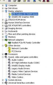

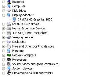

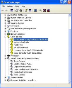

  3. Hello, Already done. No effect (only the name changed). Done, but no effect. To be sure, I uninstalled drivers for AMD (the driver dissapeared from device manager), and run the executable - the catalyst (without restart between these actions). Anything new in Device manager after running the executable - see capture 2. After reboot, automaticaly the system recognise the AMD Radeon HD 7600 M Series (see capture 1), with the yellow mark. I unzipped the package with 7zip, and tried also to update the driver directly with Have Disk, pointing to the 4 *.inf files found in the package, one by one. I received every time the same message: "The specified location does not contain information about your hardware." see capture 3 Gabriel

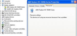

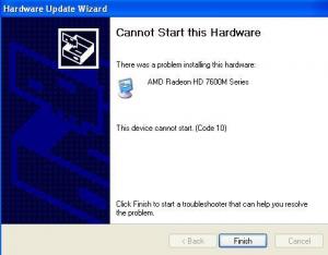

  5. Hello, I already uninstalled AMD and Intel display drivers, unfortunately Intel uninstalled also the audio drivers (I don't know exactly why), but I reinstalled all in a different order - first the AMD driver, without CCC, but it is still with yellow mark. I cannot do many things in BIOS, it has no so many options to change. The model of the notebook is HP Pavilion g6-2011sq - hardware ID of the Intel video device from Device Manager (which is OK) PCI\VEN_8086&DEV_0166&SUBSYS_183E103C&REV_09 PCI\VEN_8086&DEV_0166&SUBSYS_183E103C PCI\VEN_8086&DEV_0166&CC_030000 PCI\VEN_8086&DEV_0166&CC_0300 - hardware ID of the AMD video which is not functioning PCI\VEN_1002&DEV_6840&SUBSYS_183E103C&REV_00 PCI\VEN_1002&DEV_6840&SUBSYS_183E103C PCI\VEN_1002&DEV_6840&CC_030000 PCI\VEN_1002&DEV_6840&CC_0300 This device cannot start. (Code 10) Thank you, Gabriel
  6. Hello, The problem isn't in fact the error messages from CCC, but the yellow mark of the Display Adapter. Possible that the CCC error message is only a consequence, I don't know. I removed CCC, and let the drivers. I have no more error messages, but the yellow mark is still there. Gabriel

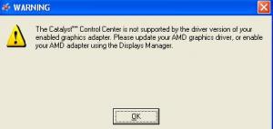

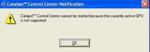

  7. Hello, Thank you all for your support. I tried all the solutions mentioned above, even the "modded" ones, but it is still not working. Possibly is not a driver problem. I receive error messages from the Catalyst (see captures), as: "Catalyst Control Center cannot be started because the curently active GPU is not supported." I searched and found that some people fixed this problem with a BIOS setting, but I didn't find that option in my BIOS. Best Regards, Gabriel

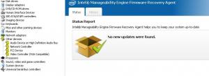

  12. Hello, Thank you. I downloaded from the links indicated above. "Intel Chipset Utility and Driver" fixed SM Bus Controller and Universal Seriab Bus (USB) Controller. "Intel Management Engine Interface (MEI) Driver" didn't find any update (see capture). For the Network Controller, the ID is: PCI\VEN_14E4&DEV_4727&SUBSYS_1795103C&REV_01 PCI\VEN_14E4&DEV_4727&SUBSYS_1795103C PCI\VEN_14E4&DEV_4727&CC_028000 PCI\VEN_14E4&DEV_4727&CC_0280 But, the Audio device is still not working, I cannot find the drivers. Happy New Year ! Gabriel
  13. Hello, Thanks for help. It seems that the problem is fixed partially. Sound, video and game controllers are OK, but I still have no sound. There were 2 devices in fact, the second is Audio Device on High Definition Audio Bus: Hardware Ids: HDAUDIO\FUNC_01&VEN_111D&DEV_76D9&SUBSYS_103C183E&REV_1001 HDAUDIO\FUNC_01&VEN_111D&DEV_76D9&SUBSYS_103C183E PS : a lot of devices are not recognised, but the sound is essential. Thanks, Gabriel
