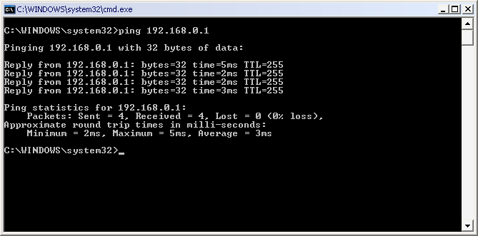

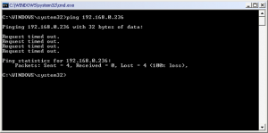

Can the computers see eachother at all - have you tried pinging one from the other?
to ping a computer:
open cmd.exe
type
ping ###.###.###.###
where the #'s represent the IP address of the computer. If you get a reply somewhat like this:
Showing replies, not errors like this:
Then the computers are connected over the network.
To get the IP address of a computer, open cmd.exe and type ipconfig /all. You should see your IP address somewhere down there.
