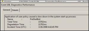

I'm not familiar with event viewer. I did what you suggest. for example in the picture below. where can i determine exactly the cause of the problem because i can see a long degradation time but i don't know what is it

If you look in \Windows\system32\GroupPolicyUsers, do you have any files or folders in there?
Nothing inside

your best bet is to use Process Monitor, it will give you an excellant understanding of what is happening when your machine boots up

OK, so please download process monitor and get a boot log. Once you reboot, open process monitor and save the log as a .pml file (the default), and then compress it and put it somewhere we can all look at it :).
