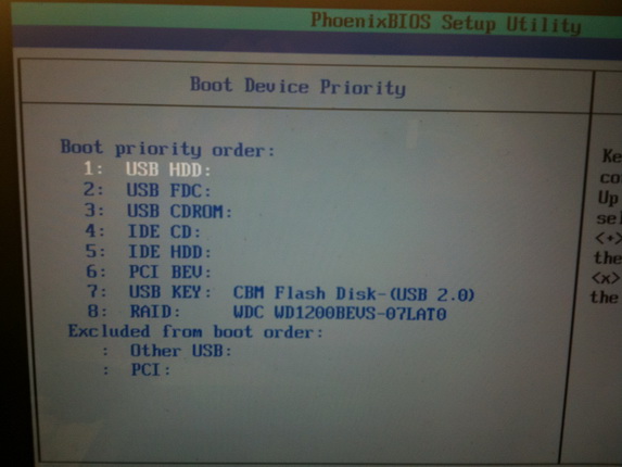

#640 User is offline   Axxoul
  • Group: Members
  • Posts: 5
  • Joined: 12-November 09
Posted 13 November 2009 - 10:00 AM
Thanks jaclaz, attached is the MBR_HardDisk1.dat file
Took the first sector of physicaldrive of the usb key...
Here is a screen of my bios:
Posted Image
