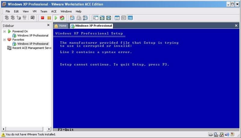

After i changed that entry in the winnt.sif file i keep getting this, i haven't changed anything else in any other files. I have change the entries back to the way they were and still i get this error message.
Is the manufacturers file referring to winnt.sif? or another file?
This is the error i receive:

\ok, if you search and using the fault message given "the manufacturer provided file that setup is trying to use is corrupted", you will see that this is common with SATA & Raid controller errors, post your TXTSETUP.SIF Files..
I just added tis to the end of the file...
[SourceDisksFiles]
iaStor.sys = 100,,,,,,3_,4,1,,,1,4
[HardwareIdsDatabase]
PCI\VEN_8086&DEV_27C3&CC_0104 = "iaStor"
[SCSI.load]
iaStor = iaStor.sys,4
[scsi]
iaStor = "Intel® 82801GR/GH SATA RAID Controller (Desktop ICH7R/DH)"

Posted 06 March 2009 - 05:38 PM
ners,
Thankyou very much for your help. i have finally got it sorted.
I used your example of adding the text to the end of my txtsetup.sif file instead of adding it within the file, i don't know what difference it made but its worked.
I used exactly the same text as before just added it to the end of the file...........
I'm now plugging slowly through adding my prefered apps which seems to be going really well so far.
