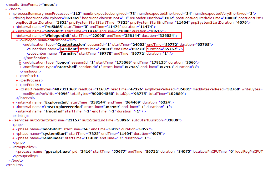

ok, you have 2 issues:
1st: running the group policies takes 65s
2nd: restoring the network connections takes 137s.
so fix both and your boot is fast again.

When you generate the XML you can see that WinLogonInit takes most time:
post-70718-0-44728500-1341676400_thumb.p
And the GPClient takes 65s.
