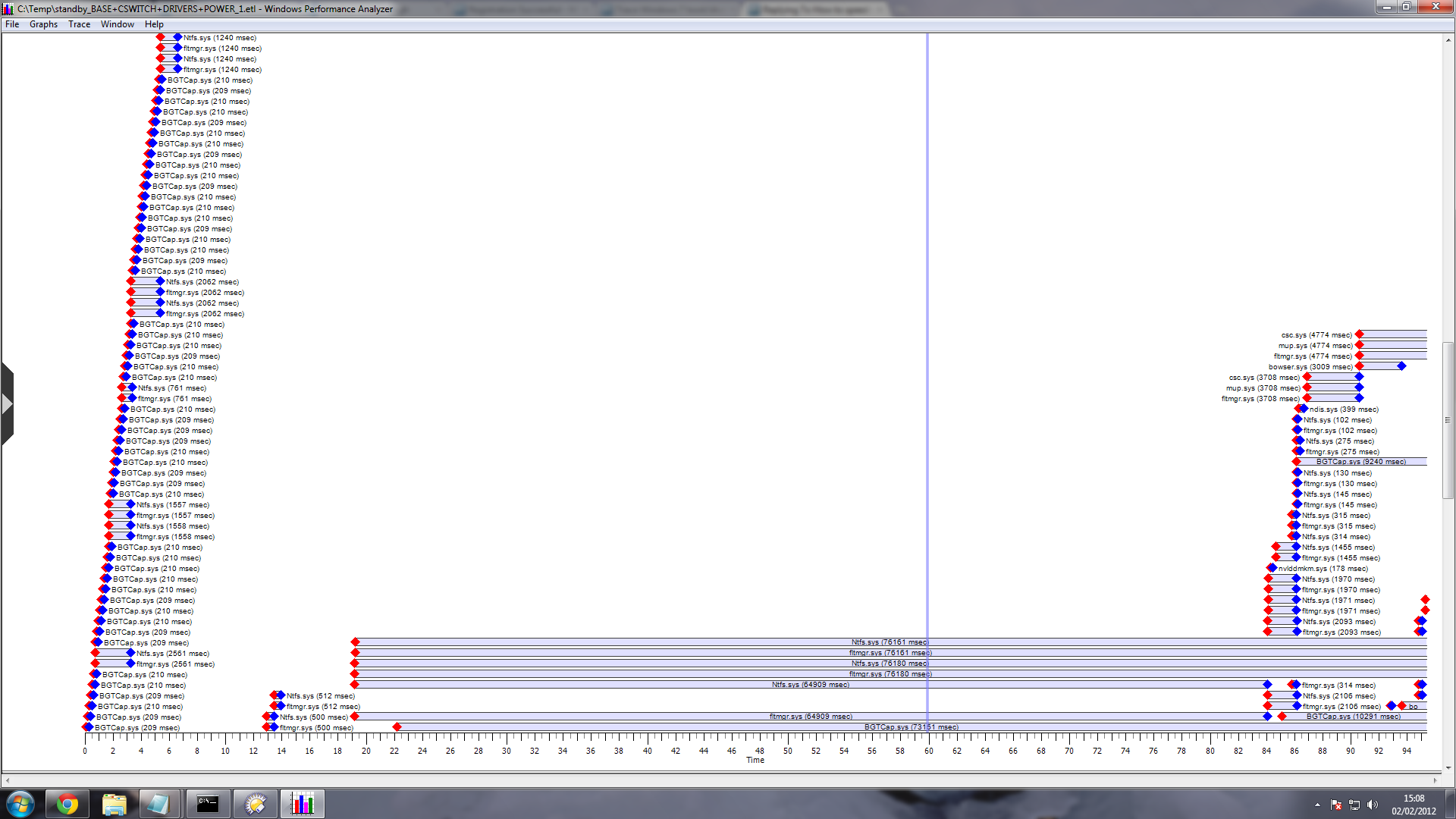

Here is a full boot trace made after the optimization above:
http://www.mediafire.com/?6hg4c8mtmv8b1u2

your HDD is busy all the time. Do you connect the HDD to the marvel chip?
you still have a lot of tools/services running (Lenovo tools, Windows Home Server tools, HP driver tools, Intel tools, Acrobat speedstart, JAVA Updater, Windows Live Messenger). Reduce the number much more
