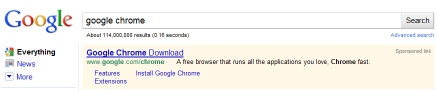

maxXPsoft Posted July 22, 2010 Share Posted July 22, 2010 (edited) I came to know that if I install Google chrome in my current OS and then copy the entire folder from "C:\Users\Administrator\AppData\Local\Google" and then paste it in my mounted install.wim. Will it work noramlly??????????you tell us after you try actually i had never tried it but I tracked changes while it installed and it creates things here alsoAppData\Local\Apps\2.0Also lots of registry entries so right now you are better off running in setupcomplete.cmdFunny, google pays itself sponsored link? no wonder their stock is ridiculous Edited July 22, 2010 by maxXPsoft Link to comment Share on other sites More sharing options...
