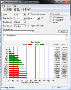

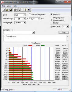

Here are some benchmark results. Not sure if those parameters make sense.
Also, thank you for your help so far.
