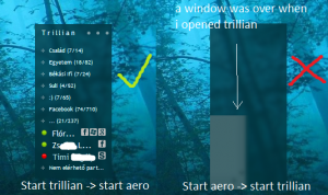

skyli Posted February 4, 2013 Share Posted February 4, 2013 (edited) Hi!For me, glass doesn't apply to the taskbar, ony the windows. Is it normal in the preview?And if I start trillian (chat program which has aero glass background in it's theme), dwm crashes. Here is my crash log:DWMHook: 0x1AAA4DAA: InstallDWMHookDWMHook: 0x1AAB203A: InstallDWMHookdwmcore: 0x1C6D93FA: MilConnectionManager_NotifyHostEventdwmcore: 0x1C6D917E: MilConnectionManager_NotifyHostEventdwmcore: 0x1C6D96EE: MilConnectionManager_NotifyHostEventdwmcore: 0x1C6D6CB1: MilConnectionManager_NotifyHostEventdwmcore: 0x1C6D64B0: MilConnectionManager_NotifyHostEventdwmcore: 0x1C6D60AF: MilConnectionManager_NotifyHostEventdwmcore: 0x1C6D6FB7: MilConnectionManager_NotifyHostEventdwmcore: 0x1C6DD5C5: MilConnectionManager_NotifyHostEventdwmcore: 0x1C6CE586: MilConnectionManager_NotifyHostEventdwmcore: 0x1C6CDFF3: MilConnectionManager_NotifyHostEventdwmcore: 0x1C6D1E74: MilConnectionManager_NotifyHostEventdwmcore: 0x1C6D272C: MilConnectionManager_NotifyHostEventdwmcore: 0x1C6C6850: MilCoreClientIsDwmdwmcore: 0x1C6D3133: MilConnectionManager_NotifyHostEventdwmcore: 0x1C6D4B15: MilConnectionManager_NotifyHostEventdwmcore: 0x1C6CC310: MilConnectionManager_NotifyHostEventdwmcore: 0x1C6C5F4F: ?dwmcore: 0x1C6C5A5A: ?dwmcore: 0x1C6C5837: ?dwmcore: 0x1C6C42F0: ?dwmcore: 0x1C6C41BD: ?dwmcore: 0x1C6C2C26: ?dwmcore: 0x1C6C1F84: ?dwmcore: 0x1C756B5C: MilCompositionEngine_InitializePartitionManagerKERNEL32: 0x27BF167E: BaseThreadInitThunkntdll: 0x29233501: RtlUserThreadStartI have 2 aero themes for trillian and one is working but only if i start trillian before and dwm after. If I start dwm first, then the window content will not be visible.Thank you for this app! Edited February 4, 2013 by skyli Link to comment Share on other sites More sharing options...
Tihiy Posted February 4, 2013 Share Posted February 4, 2013 Trying to work this around via black list won't succeed, too many programs can fail when their state is externally modified. It would be better to trick DWM into thinking windows are layered while they aren't. I didn't find a way yet, but there should be. Link to comment Share on other sites More sharing options...
KittBlog Posted February 4, 2013 Share Posted February 4, 2013 I have no problem with the tweak and Trillian... Link to comment Share on other sites More sharing options...
skyli Posted February 4, 2013 Share Posted February 4, 2013 I have no problem with the tweak and Trillian...Try APB skin or Avion Pro 5.2 Link to comment Share on other sites More sharing options...
