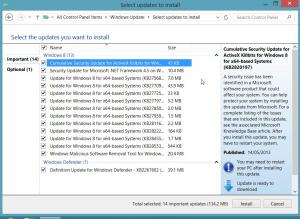

Have noticed more & more patches lately that won't integrate offline applied to an image! Dism says it integrated 100% but still shows on WU??
See image attached understand there are a few non MSU fixes there that I don't care to integrate though there are many others that I do!
Am I overlooking something here? If so please chime in.

Windows 7 had this problem too with some updates. You didn't get an error from DISM on the CMD screen but buried in the DISM.log you'd find the error. Which updates are you specifically having a problem with?

Thanks Trip I like to int most Sec & Non Sec msu's incl Net, though don't require Wind Def or MRT fixes.
Have up to date as of last patch Tues. fixes less the ones in the pic I posted above.

upload the DISM and CBS.log from the system where you integrated the updates.
Thanks, just interrogated my system & have deleted my most recent logs, will be sure to save following the next integration!
