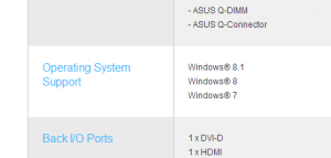

Kelsenellenelvian Posted December 27, 2013 Share Posted December 27, 2013 (edited) http://www.asus.com/Motherboards/GRYPHON_Z87/#specificationsThis quite plainly says it only supports windows 7, 8 + 8.1 Edited December 27, 2013 by Kelsenellenelvian Link to comment Share on other sites More sharing options...
Dogway Posted December 27, 2013 Author Share Posted December 27, 2013 http://www.asus.com/Motherboards/GRYPHON_Z87/#specificationsThis quite plainly says it only supports windows 7, 8 + 8.1No, it just says what it does support. You are reading the "only" from somewhere else.Anyways, now reading it seems that Asus, or Asus Gryphon is not one of those companies because I keep seeing posts of people saying that they disabled secure boot. I just need to know how, I read the reset BIOS didn't work, I checked setting an admin password and didn't either, now I read that disabling CSM (which is strange, but who knows) Link to comment Share on other sites More sharing options...
