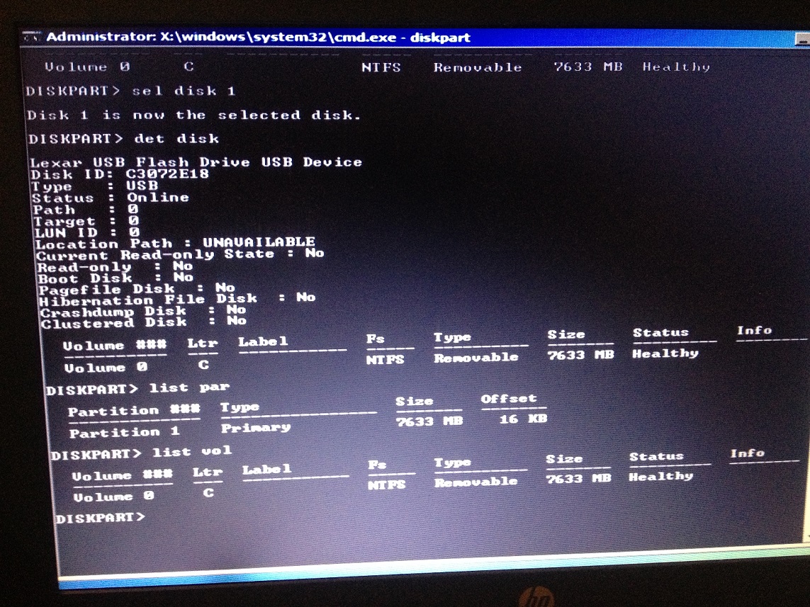

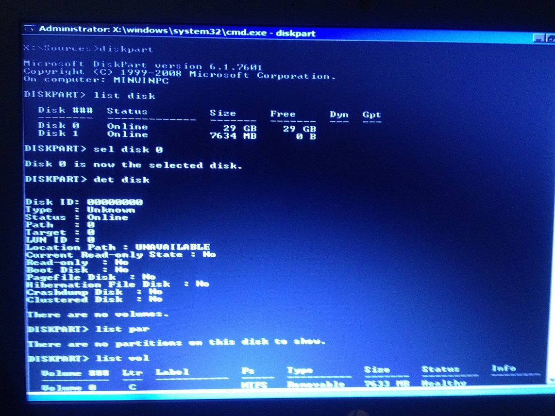

Tsundere Posted July 5, 2016 Author Share Posted July 5, 2016 @cdob Sorry for the delay, here are 2 screenshots from the latest attempt, this time booted from a new 8gb flash drive. boot.wim+emmc(corrected)+usb3 drivers but I excluded the usb3_fix.cmd and there was no bsod this time. Perhaps it is no a media card reader issue? On 22/06/2016 at 8:20 PM, aviv00 said: use dism or gimagex to apply install.wim image from win7 iso / disc I think I have been doing that, but with boot.wim. I don't understand your other instructions Link to comment Share on other sites More sharing options...

Tsundere Posted July 6, 2016 Author Share Posted July 6, 2016 (edited) 17 hours ago, aviv00 said: then u can apply the image install.wim to it Yes I am on win 8.1. You mean apply Windows 7 install.wim onto my emmc drive? I think that's too risky atm since the win7 setup isn't detecting it properly (see screenshot above). Win7 diskpart is detecting it as type: Unknown Edited July 6, 2016 by Tsundere Link to comment Share on other sites More sharing options...
