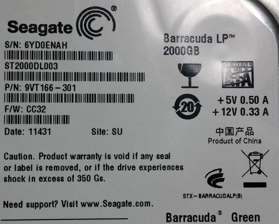

Yesterday my old trusty ST2000DL003 suddenly disappeared and nothing I did mattered.

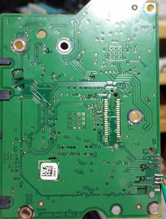

Fortunately, after some soldering, fidgeting and cursing I managed to get the F3 T> prompt, where I entered the commands given in this tutorial.

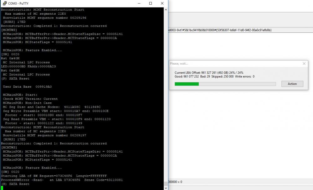

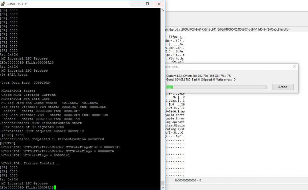

However, while copying the disk at random intervals just outputs the dreaded LED:000000BD FAddr:00008A23.
As a result, the copying stops and I have to power off and on the drive so that the copying can be continued.
That is of course a very arduous process, and I was wondering if there is a way to stop that from happening, so that the copy isn't interrupted.

Just thinking aloud here, posting for future reference:
It seems that what I'm doing is something like "DDOSing" the LED error.
The recovery software is reading so fast that the LED error just keeps waiting, until it happens. Then I have to power cycle.
To accomplish that in DMDE I reduced the buffer size to 128 and set the sector skip on error to 2000.
The result is that it's of course disgustingly slow when encountering errors, but I can (relatively) safely let it do its thing and FINALLY go get some sleep!

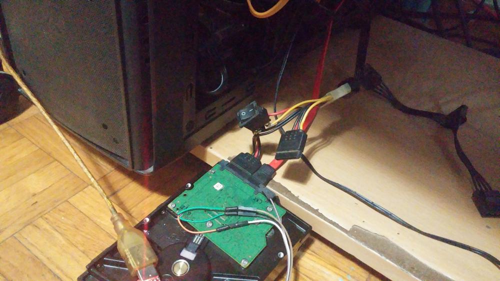

Inner ramblings pt. 2:
If you're determined to spend the rest of your days off trying to fix this stupid thing, you better make technology work for you, or your fingers will end up sore because of all the times you un/plugged the freaking SATA power cable:

Hmmm, just in case (to avoid the cutting and soldering for those less inclined to DIY) what I would have used (actually what I normally use) is a power adapter like the one here (example only):
http://www.legitreviews.com/vantec-sata-ide-to-usb-3-adapter-review_131412
Inserted in an extension cord with a switch, like (again example only):
https://areaillumina.com/ciabatta-multipresa-elettrica-9-posti-interuttori-bipasso-presa-multipla-vultech.html
