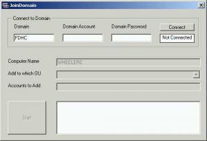

I have had issues where the NIC isn't active until after the first reboot or at some point after joining happens. therefore I wrote a tool to run at runonce.
Attached File(s)
  • Attached File  join.jpg (18.33K)

hi all
RADIMUS, Im very interested for your graphic product or tools Join Domain , could you explain us what is it or give us the source ?
Thanks a lot
#11 User is offline   Radimus
  • Advanced Member
  • PipPipPip
  • Group: Members
  • Posts: 309
  • Joined: 14-June 04
Posted 20 July 2005 - 06:57 AM
The tool is written using Kixtart and the Gui addon Kixforms.
basically add the joindomain.kix, kix32.exe, and kixforms.dll into the system32 dir, "regsvr32 /s kixforms.dll", and then "kix32 joindomain.kix"
see http://www.kixtart.org/ubbthreads/showflat...4&Number=131272
for the details on the code for this
